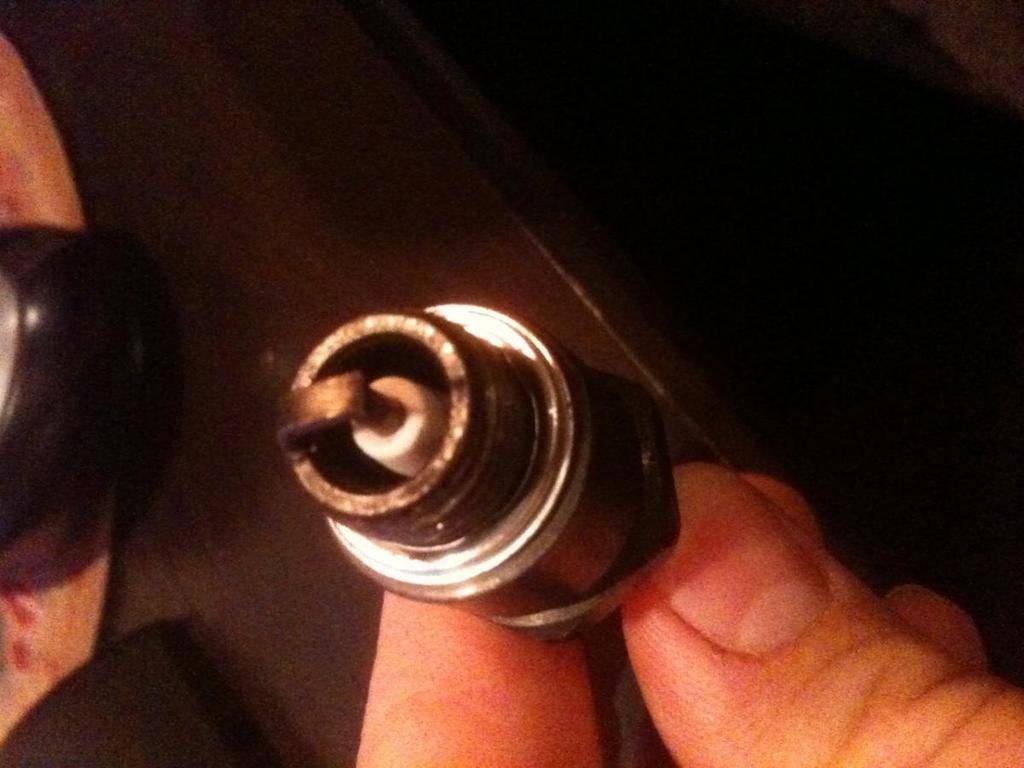

What do the plugs look like? what brand/heat range are they? Just as important is what is your cranking compression (compression test), as the early engines usually needed a hotter plug.

From the box edelbrock's are adjusted lean, after I fixed the leaks and re adjusted the timing I adjusted the carb full rich. I got the smell of un-burnt fuel all the way in the engine bay(mind you this is a station wagon and that has to be rich to smell it that far away.) It didn't really have much of an effect if any. So my next step was to lean it with jets and rods. Went 4% lean, ran a little smoother, so went the next step down to 8% and no change. Just for ****'s and giggle's I then went 4% richer from base calibration(out of box) and had little to no change(the idle got rougher and idled higher) I have now gone back to 4% lean as that is where it runs best. As for the plugs the old one's looked a little carbon fouled, but since I have put the new plugs they look pretty good, I'm attaching a picture of my number one plug taken a few weeks after the carb and ignition change. at this point the plug had about 40 miles on it and eight hours idling in my driveway diagnosing. My feeling about this problem is that it is something horrible simple yet not very obvious...

First of all I have to wonder why you are running plugs with a recessed tip. Get a set of Autolite 85's. Also, a 750 is way too much carb for a bone stock 383. Not that it's solely responsible for your idle condition but for the sake of properly matching up parts a 600 is more than enough. Is your firing order correct? 1-8-4-3-6-5-7-2 with #1 at the drivers front.
