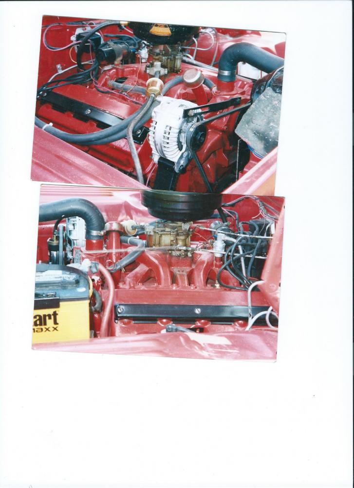

I've put a 315 super power giant hemi (Poly block) out of a 58 dodge d 500 truck and put it in a 66 dodge step side pick up. it replaced a slant 6 bolted right up to the tranny. I plan to find another 315 or 325 hemi and put it in my 65 satellite with a edelbrock p600 3 deuce set up and stroke it to@ 402 c.i.

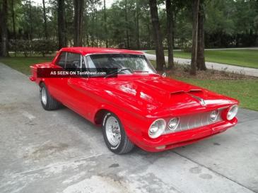

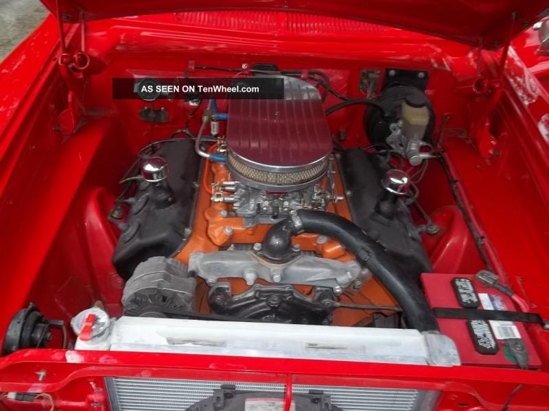

392 in Valiant
http://blogs.hotrod.com/when-is-a-392-hemi-not-a-392-hemi-92715.html
315 hemi in a 60's b body
Scan.jpgi'll try to scan some pict's of my 66 pick up in a day or two add to the pictures a 3 deuce manifold to the baby hemi it's a early 318 w/ hemi heads
