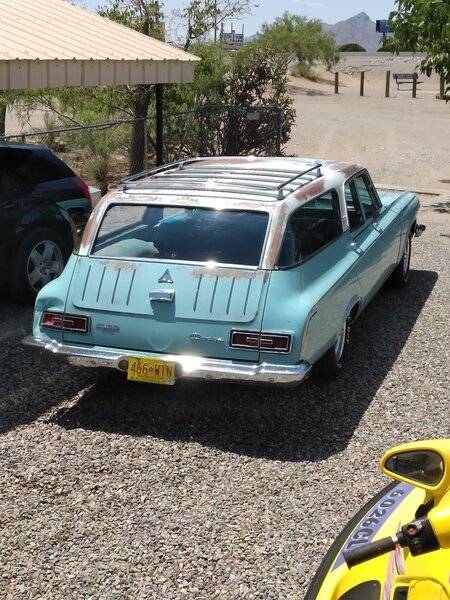

PS: your wagon is still a favorite of mine!
