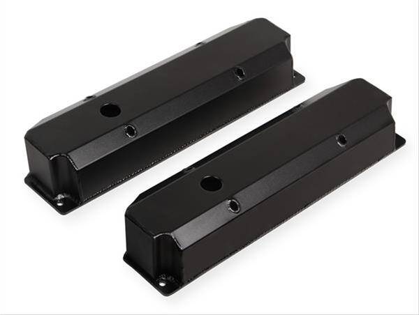

Hi guys! I have a 440 that's popping the dipstick at high rpm. I currently have a pcv on one side and a breather on the other. I would like to keep the pcv and have a raised (not push in) breather on both sides. The valve covers need to be tall also because of roller rockers. Can't seem to find any tho. Any suggestions? Thanks in advance!

Mopar Performance has these kind of RB valve covers. I too have roller rockers, and the covers clear. They're a lot bigger than the other MP finned valve covers and factory covers, which makes the engine look awesome. Think I got mine from either Jegs, Summit, or Mancini.
