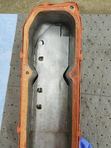

Similar trouble with the summit covers on my iron heads, the baffles under the grommet hit the shaft holddown bolt. (At least that was why they didnt work on mine.) Im just gonna shave down the thickness of the bolt head. If that doesnt work, im gonna redo the baffle.

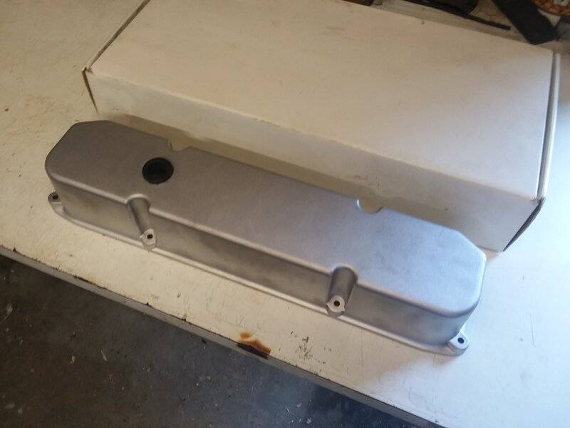

I have seen the no-logo indy covers. In my humble opinion, they are identical to the chinese ones summit offers.....only $100 more.

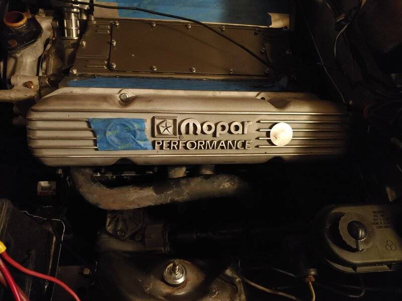

Yes that was one of my problems with the fabricated ones I was getting from Summit,the thread angle but Petes Garage on YouTube was doing the exact setup im doing and answered me about the valve covers he was using, Mopar Performance PT#P5007614 but said their hard to find and they were but finally located some at Mopar Overstock for 149.00 plus shipping-now hopefully I dont get that Email saying their backordered...

I use a stock set of 1969 440 valve covers on my 505 stroker with trick flow 240 heads and Hughes 1.5 ratio roller rockers. Just had to clearance the baffles in a few areas.

Yep, could be. Could be too, that indy gets them from the same place summit does, then marks them up a hundred bucks. (And puts em in an indy box, I'm sure. Mine came in a plain white logo-free box.)

I dont doubt that their intakes, heads, and blocks are cast in the US. These are the cast finish summit covers i bought (i think no longer available unpolished). Frankly, i assumed they were chinese, but there is no marking on the box or the part, as to origin. The packaging hints strongly to me.....but i cant prove anything.
