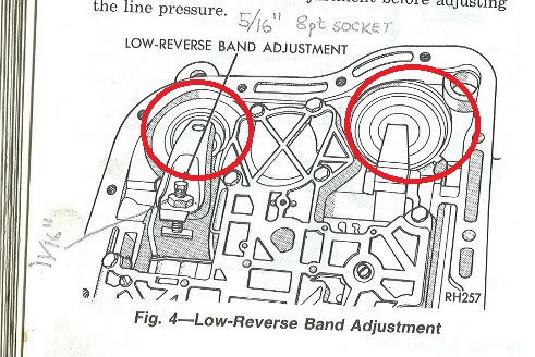

I hope in your case it is only needing a band adjustment. Google "Rebuilt 727 with excessive slippage" and see what pops up. Good luck!

could be anything hanging it up, like SlinktRT said could be brakes, but on one trans i rebuilt I accidentally put in one of the band actuator caps in upside down, and upside down it was about a 1/4' taller causing the band to drag, basically trying to partially put it in 2 gears in the same time. Just some ideas i had
