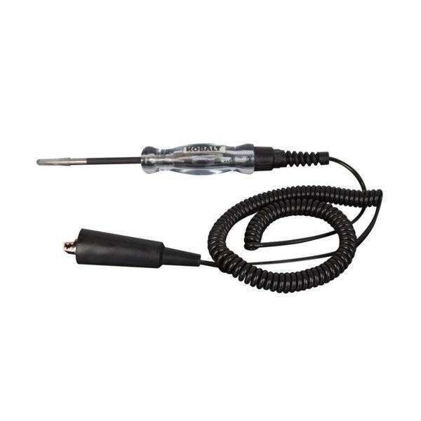

I agree with @moparnation74. The bulkhead is a problem area for old Mopars. You should also invest in a quality test light and trace your power, see where it ends. That is where you should start your diagnosing. Here is a good light for under $15.00.
https://www.lowes.com/pd/Kobalt-Circuit-Tester/999957789
