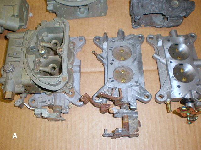

Picked up two Holley #4783 carb's one near perfect and one needs the base replaced.They were in a five gallon bucket one on top of the other the bottom one was at one time in water just on the base. My question is will a AED6450--500CFM base work on the #4783 carb ?
Thanks POPS

Yes they are direct connection carbs. The base pictured sure looks the same,linkage looks a little diff.
Same base,different linkage,getting these back together eventually.

check to make sure throttle bores are the same.
No they will not interchange. 4783 has 1 3/4 plates vs the smaller 750 size Bore/plates of the 4412.
With some boring and fab work it may be possible. Your idle circuit is also different.
