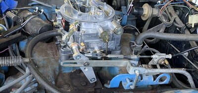

I sure am liking the avs2 i put on my 400. I made the bracket for the kickdown. It is just a piece 1/4 thick aluminum and some 1/2 spacers.
Looks good! I think you'll be happy with that setup.
