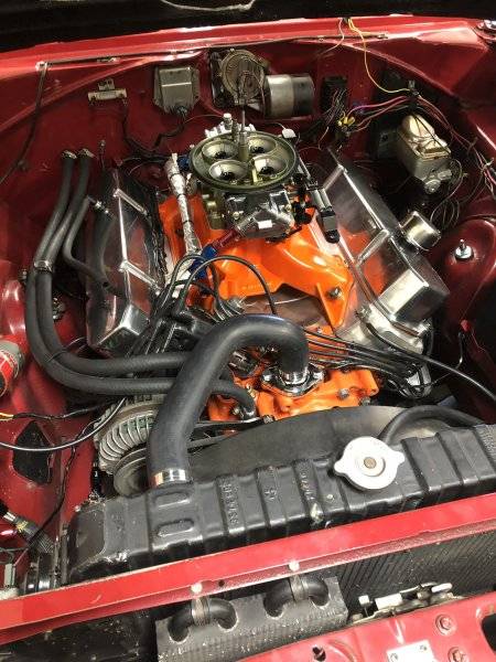

This is the car we put the M1 on. 10:1 440 with edelbrock heads, mild porting, and the biggest extreme energy street roller comp sells. 4.10 gear and a loose 10” vert. Hardly a race car.
