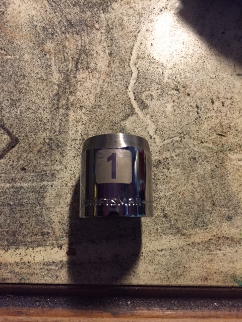

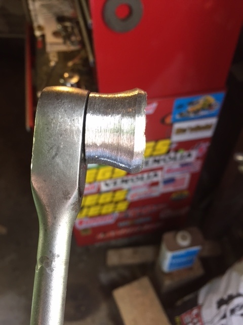

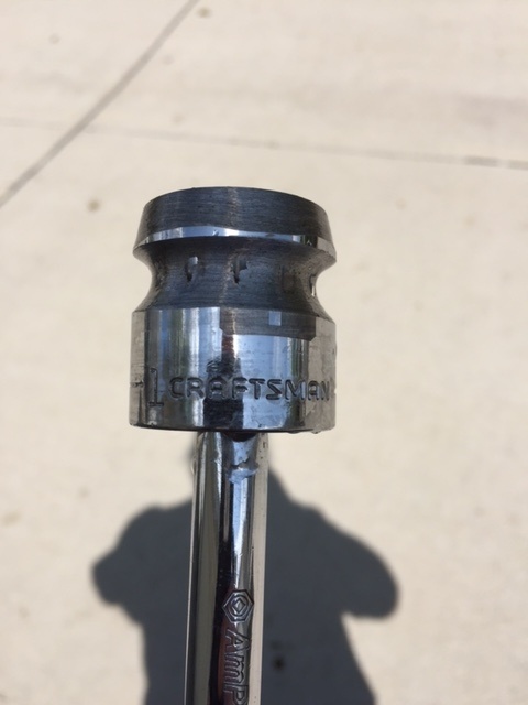

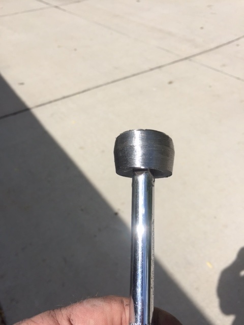

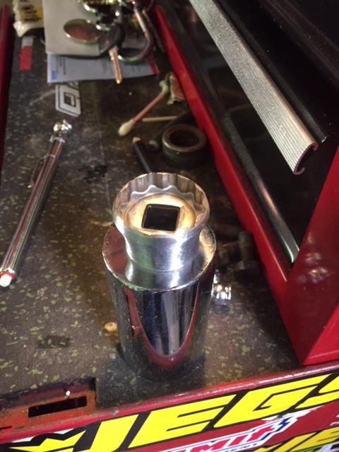

I see lots of commentary on the end thickness... I just went thru this and did something about it! I always had an issue with the fuel fittings on my Holley carb
... box end don't fit, socket don't fit, open end don't grip properly... So I custom made a socket. Works great!
