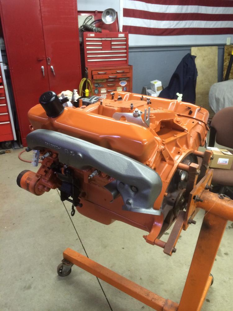

Hi All!
I have a 1969 Roadrunner with 383HP / auto transmission and air grabber. Can anyone tell me what make and part number carburetor came on this car as original equipment? image.jpg
