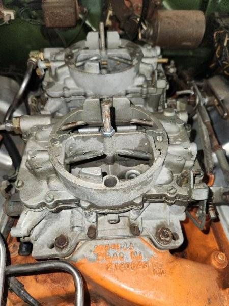

These are on a Hemi car I bought. Any info on these and are they desirable. Part numbers are CO 4345s and CO 4346s.
Are they rare or sought after.

Probably really desirable to any 1967 WO or RO owners. Anything Hemi related is worth good money. I haven't been fortunate enough to own either of those cars. The numbers were really low when produced. I'm not going to put a value on them, but they should perform good on your car.

Just curious because I doubt I keep them for myself. Thanks for the info on them..what are they 650 cfm

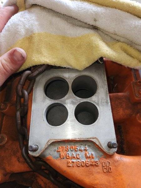

The manifold is 66/67. @Jerry Hall all would the manifold have primary holes enlarged or modified to a Vanke style. Thought the primaries on SS cheater carbs were to large for a stock intake. Would like to see bottom of carbs and intake without carbs. You've got some nice things.
Keep those carbs. They're a nice upgrade from stock. They're the same size as 67 440 magnum. They have the same throttle bore and venturi size as 750 edelbrocks. Keepers!
Open those primary holes to 1 11/16" and you're golden.

Those were not original carbs to the 67 RO, those are the over the counter cheater. The date code is C0 March 1970. They were used with the Vanke modified hemi intake which made it better for Drag racing, more cantankerous on the street. Since you do not have the Vanke manifold some one took off the original hemi carbs, and slapped those on. They are worth less that Street hemi carbs.
