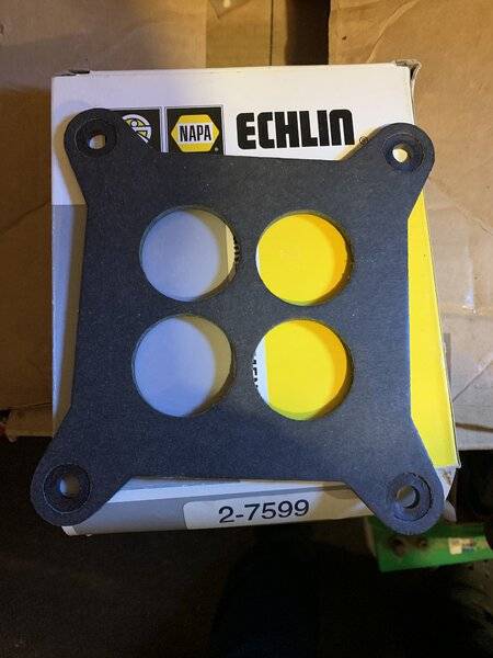

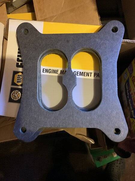

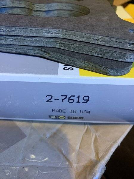

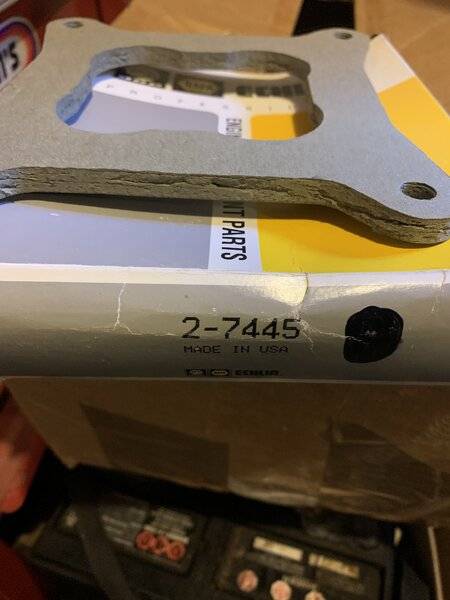

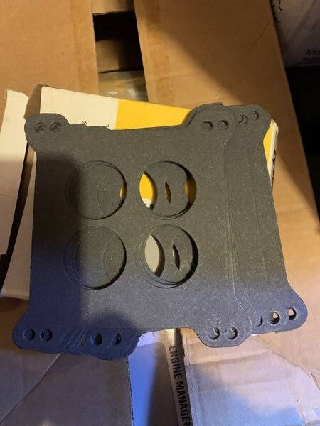

Here is a few of my collection. Kim
910CA24A-D1C0-410C-8896-FEDC1787C412.jpeg 92754A03-5240-46B9-9BAD-D83F11D11ED6.jpeg 03791688-4589-413A-8AD5-51A4EA9267D7.jpeg 8949F13F-A93D-4B1E-BAD5-F26CC8AF1403.jpeg 055B400C-1232-4131-8920-EA297D1363D4.jpeg
HI if this is a stock application try and use one of those thick gaskets like above the Echlin 2-7599 has the plastic inserts so you don't over tighten the gasket, or the 2-7445 would work.. You want the thick gasket to help separate the carb from heat transfer from the motor..
good luck
tim
