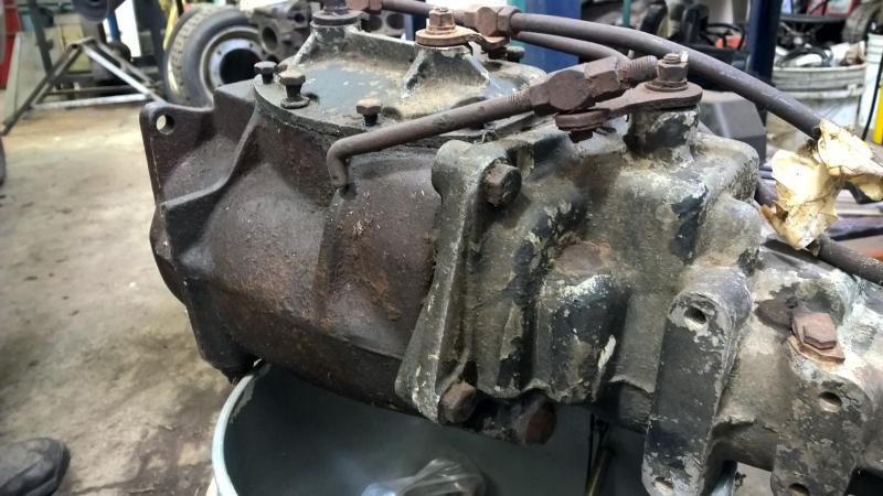

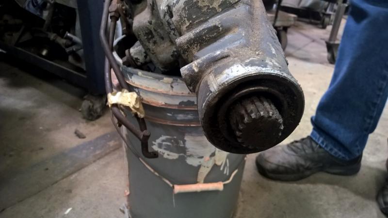

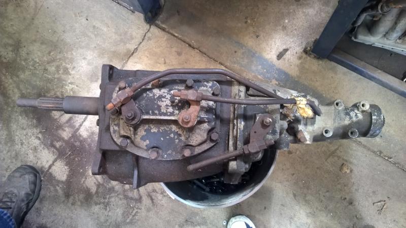

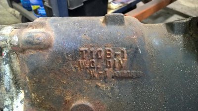

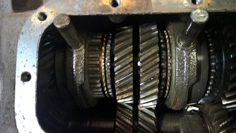

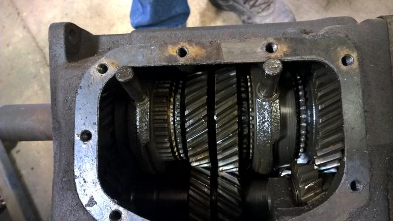

Here are some photos I took this morning. It is not a ball and trunion, but it does look very clean inside.

its a T10, but the flange bolt pattern looks screwy for a GM. i think i have rebuilt 40-50 of these in the 70's. we tore them up on almost a weekly basis due to hot-rod shifting. clean inside means nothing if the brass blocking ring teeth and the syncronizer teeth are rounded. they should be pointed and almost sharp to the touch. look in the case bottom for brass and metal filings. they will accumulate in the bottom close to the drain plug. you should be able to slide the locking ring (the ring the shifter fork is in) back and forth, but not so easily, and they should snap into a locked position as they are shifted. front toward input shaft is 1-2 gear and next is 3-4 gear. reverse gear is outside the case in the tail stock housing.
there is no good way to tell is the 1-2 syncronizer will stay in First gear without power being applied. unless you are doing a numbers correct restoration, i would not invest any money in this old transmission.
the super T10 was out sometime about 66-68 (i am guessing) and the syncros were larger diameter with different blocking rings and closer ratios. just be carefull as this trans could be a piece of crap or it might be good, but it is hard to know.

That's an odd assortment of parts. I had a 63 dodge 440 w/ hp 383 and BW T-10. I think that was the only year that it was offered. They had a limited # of 3 speed units behind 413 cars in 62. That trans has the long pilot bearing area on input shaft but has a coarse clutch disc spline. My T-10 had fine spline input shaft. Case is mopar, at least the bell bolt pattern is mopar. Output housing looks to be GM. ??? With old car parts never say never. Could be some chebby guy was trying to build a tougher T-10 for his race car. In early 70's chevy guys were shredding those BW and muncie trans on a regular basis. Someone even made a bell that would bolt an 833 Mopar trans to BB chevys. Think about those Pont guys running an alum cased T-10 behind a 421 in a big Catalina. Those guys had to have had a truckload of spare trannies on hand.

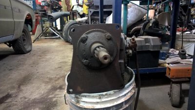

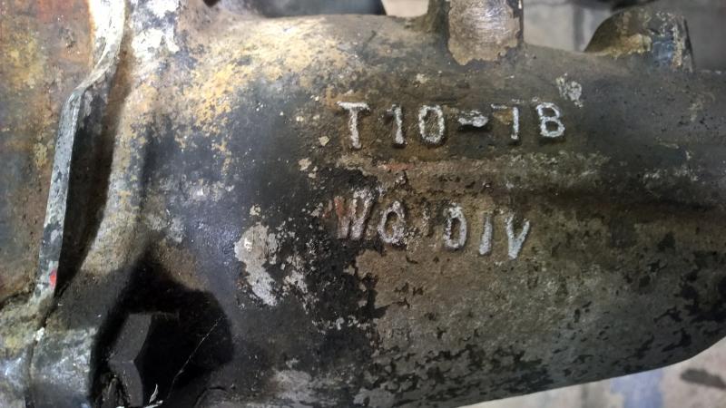

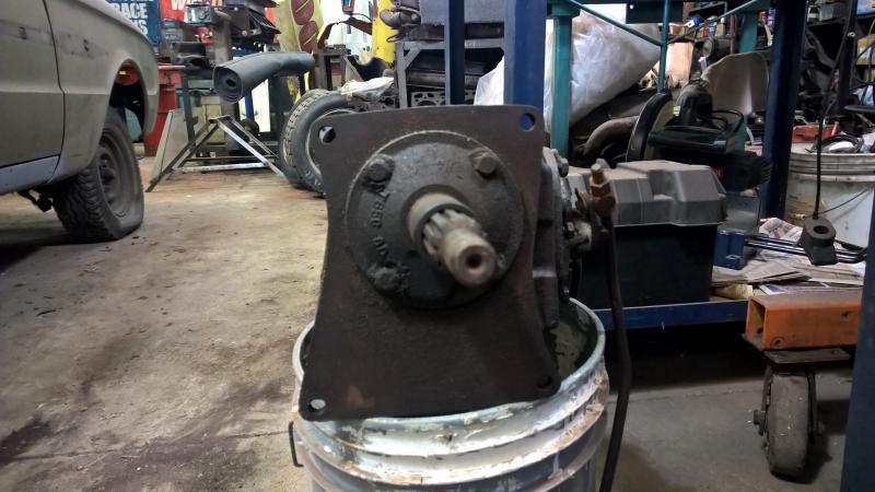

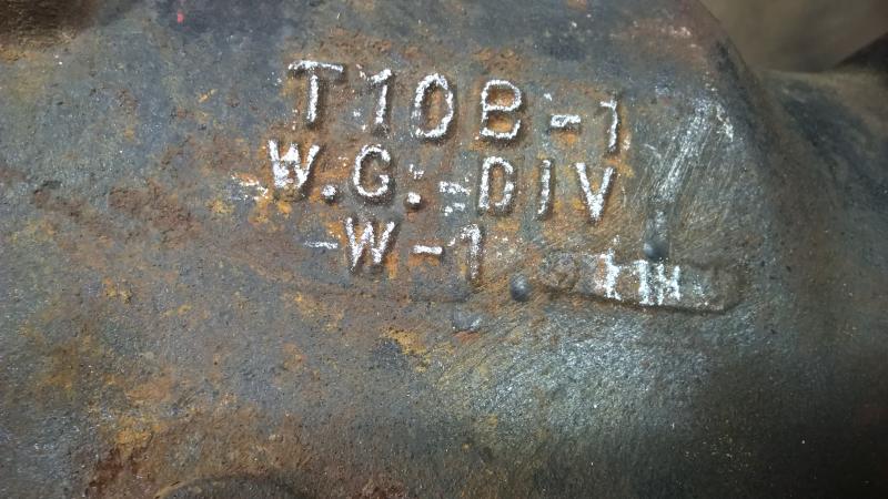

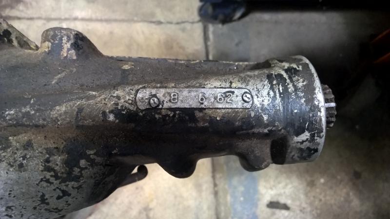

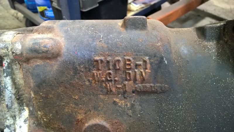

I'm not sure what this is, I hope someone can identify it. Here some more pictures ans a little more info on the T-10's.

Trans inquiry got me curious. Went to an old Hot Rod article that I had stored years ago. Might provide some info that would help to ID your trans. Hot Rod Aug. 1980, Hot Rod's guide to 4 speeds. 1) Ford used early T10 from 60-65. 2) Merc started in 62. 3) All Fords had 28 spline output shafts, GM had 16. 4) 60-62 Ford used 23 spline input shaft. 63-65 had 10 spline input. 5) Ford used 2 different length input shafts; 427 was 8 15/16", others 8 1/2". 6) last 3 digits (above WG Div) indicate type of iron used to make case. 902 = cast iron, 904 = nodular iron. Nodular iron is stronger. 7) Mopar used T10 one year only, 1963. Ford T10 used iron case on all trans except those used in Shelby race cars. Google Transmission I.D. chart, Hurst shifters. That chart will ID the trans by the tail housing bolt pattern. Finally: Ford bell bolt pattern is similar to Mopar, not exact but similar. Do some measuring, count splines, and look at the chart and you should come close to an ID. I knew those old tech articles might come in handy some day. Good luck on your hunt.
