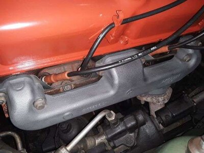

I quit using cast blast on exhaust manifolds. I used a spray graphite called Slip Plate. Stays on very well. I put it on my exhaust manifolds at the beginning of 2019 and still looks perfect today. I've never gotten that from any cast blast paint.
