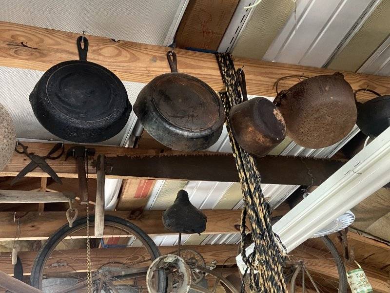

We have old Griswold pans.. You can find them at Flea markets and antique stores.
