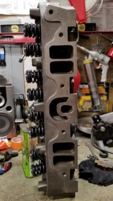

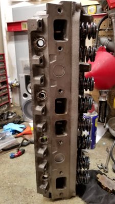

All you guys are pretty harsh on those heads. I have a set that are bad ***. Ported, 2.19 Intakes, 1.81 exhausts. Plugs moved to angle plugs. Someone dumped a LOT of money in these heads, I had them decked and hardened valve seats and valves. I'll run them over 906 heads.
The 906's usually bring more just because of the years they were produced but there's still a fairly large supply of them. Before aftermarkets heads were everywhere, I ran a car 10.60's using a set of 906's. The 915's value come from the years they were made and being more rare plus they have value being closed chambered vs the later heads being open chamber....to those that like closed chambered heads. You can make just about any of the factory heads flow decently and just doing a pocket port on them helps a ton. The factory back cut in the valve pockets sucked big time. Heck, even a 516 can perform pretty nicely if you are not looking for huge flow numbers and those are probably the cheapest ones out there as no body really wants them. 346's....most people never even heard of them. How about 902's? They all have something different done to them from the factory but how much better is each one from the others? There's info on the net testing many of them if not all and for the most part, they don't seem to vary all that much on a flow bench.....but racing flow benches is much different than real world racing or even street performance.
