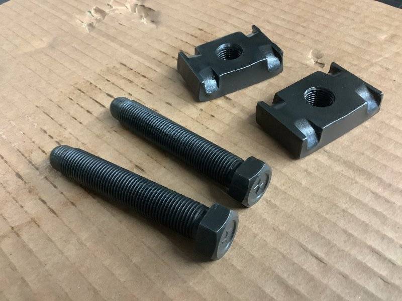

Black oxide actually alters the metal, it’s not just on the surface. Just follow the instructions to the letter for satisfactory results. I did a bunch of small parts for the GTX last winter, it’s really easy.
