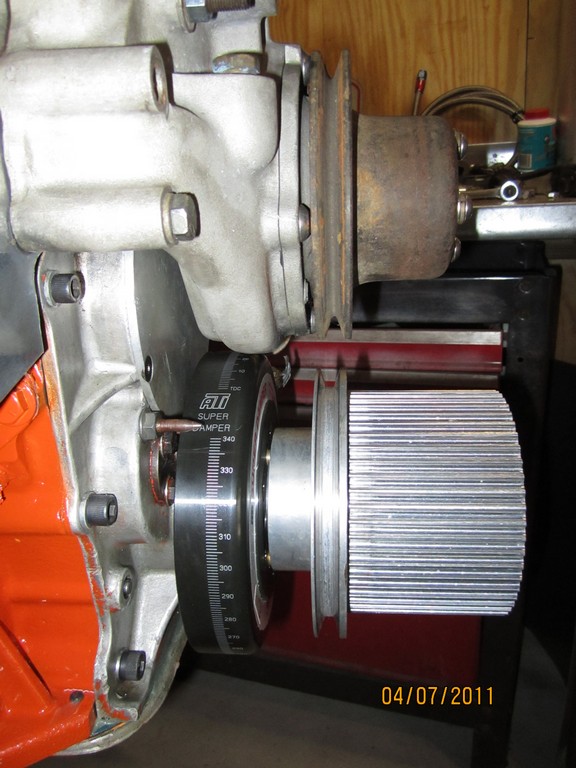

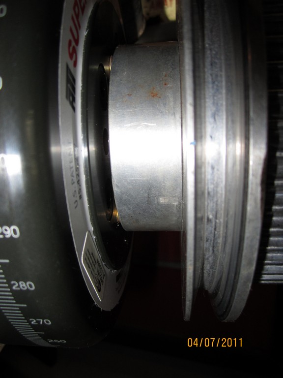

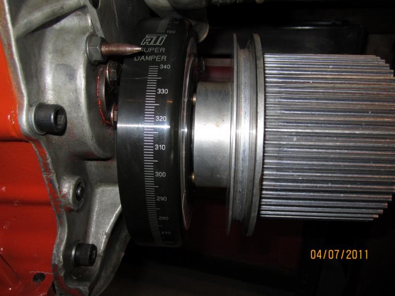

I'd like to mention this.The ATI has a 2.25 inch register hole for the crank pulley and the roots spacers & pullies use a 2 inch.I needed to open the spacer to 2.25 to fit the damper right:eusa_think:
