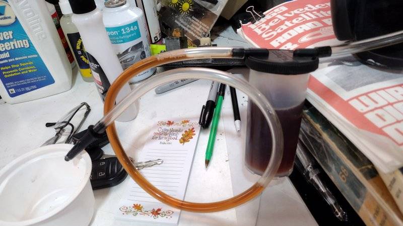

You can take the belt off or loosen, put a mitivac on each line, and suction out the fluid while slowly rotating the pulley.

Seems like a neat way to do it, I Will probably do so !
