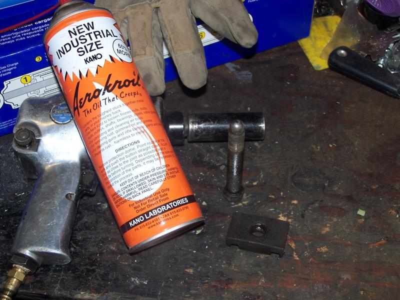

OK ran into a issue the torsion bar adjuster froze up while turning it...

How do I replace the torsion bar adjuster if I need to ?
Don't know about the Hotchkis but heavy duty parts are usually better than stock. To remove the adjuster, you remove the adjuster bolt all the way out then the flat nut will come out. Since it froze up, you will probably end up breaking it off before it unscrews....

Opened can of woop ***
frozen adjuster could not stand up to the can of woop ***
