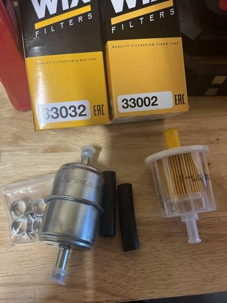

So I can’t tell when the last time my 440 had her fuel filter changed. So I bought a metal and plastic WIX filter. I tried googling and looking on YouTube but I couldn’t find anyone explaining the process on an older car.
I saw some tips about letting the pressure out of the system first by unplugging the fuse to fuel pump, running the car for a short time so that the line is clear and then priming it again (not sure how to prime it). Is this the same for older cars or could I just disconnect the current filter, spill a little fuel and connect a new one?
Any preference between the plastic or metal housing?
Just unhook and install. There is a inlet and outlet. I like the clear ones.
Go with the metal filter. Just change it when the motor is cold. Lay a little plastic dish and/or some rags under the filter and hose ends. Undo one side, tip it so most of the gas in the filter runs into the dish. Remove other end, pop the new one in. Shouldn’t take more than a minute or two.
