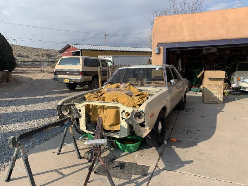

I’m asking for friend who has a 2dr 66 post car that had a /6
He got a 67 4dr from me with a
318 A/C car with a good radiator and shroud.
He is transferring everything from 4dr into 2dr.
He is having trouble finding a 22 inch 3 or 4 core radiator.
I’m suggesting that we take the radiator support from 4dr and use in 2dr.
Never having done this before I’m just wondering how difficult it is to do?
