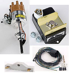

If you are using the mp or similar conversion kit, you really don't need the modified harness. A pigtail comes in the kit. Just one wire to the ballast resistor, one to the coil, and the pigtail plug to the distributor. You will have to get your tac converted to electronic in order for it to be accurate also. It will read low if you don't do this.

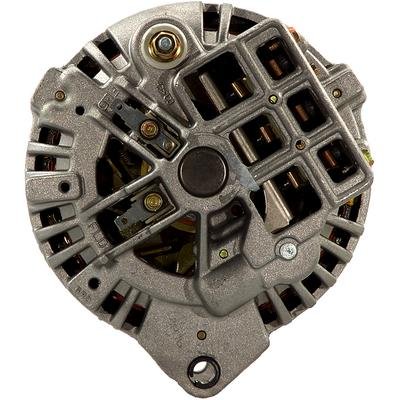

you will also need the 70 & newer dual field alternator and electronic voltage regulator as well

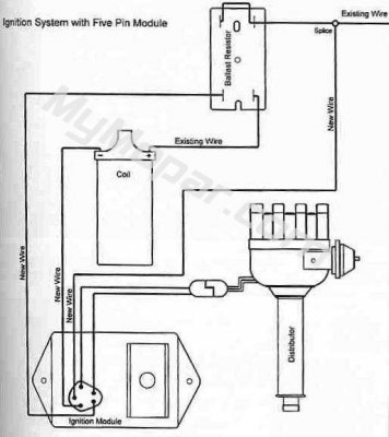

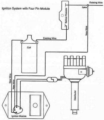

some of these may help, the one in color is 4 the 4 pin CEI

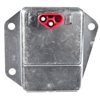

& Dual 4 pin ballast, With electronic voltage regulator, like in later years
good luck for a street/strip car the CEI is a good & reliable better alternative to points

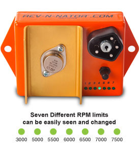

I prefer the Mopar Performance Chrome ICU over the MP Orange box,
more dwell like 20* for upto 8000+rpm if you have allot of mods,
if your combo is more toward stock the MP Orange box is just fine...

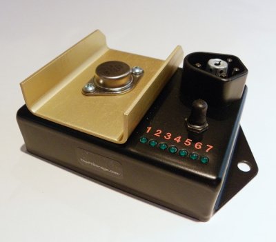

There are also decent alternative ICU {controller boxes} that will be a plug &
play by to the CEI the ignition ICU, with leds & rev-limiter built in
www.thertgarage.com Rev-N-Ator
  • Chrysler Electronic Ignition Wire Diagram 2 Pin Ballast w-4-pin module.jpg

  • Chrysler Electronic Ignition Wire Diagram 4 Pin Ballast w-5-pin module.jpg

  • Chrysler Electronic Ignition kit 361-400ci Lowdeck Jegs 555-40504K $237.99.jpg
  • Chrysler Electronic Ignition CEI-ICU #1 Rev-N-Nator www.thertgarage.com.jpg
Yep, forgot that you should have the regulator with the electronics in it. They make repos that look like the old mechanical style. As far as alternators go, you can keep your original 1 field.
You can keep the single field alt, but your going to need a different regualtor. This is the one I've been running for years.
product_thumb2.php
