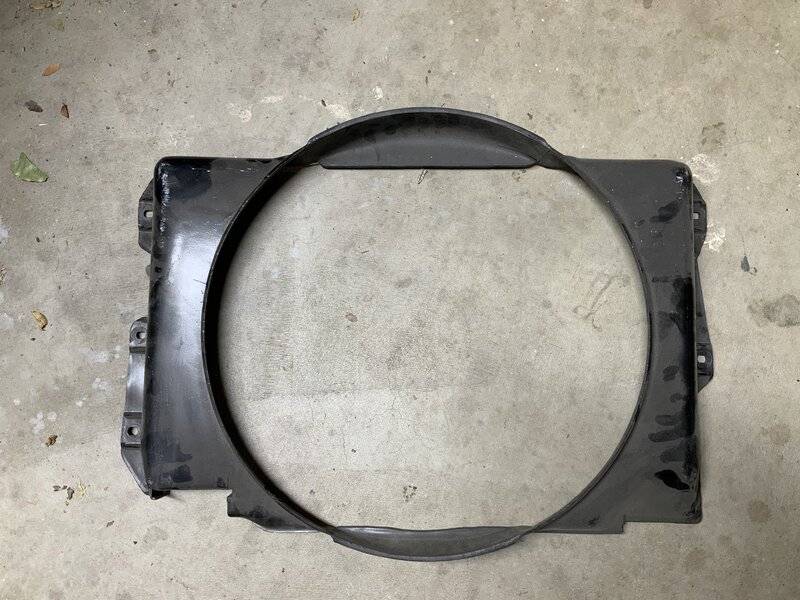

Hi everyone- I’m missing the fan shroud for my car. It’s a small block A/C charger with a 26 inch radiator. Doesn’t seem to be reproduced.
Does anyone know a part # I should be on the lookout for??
Thanks

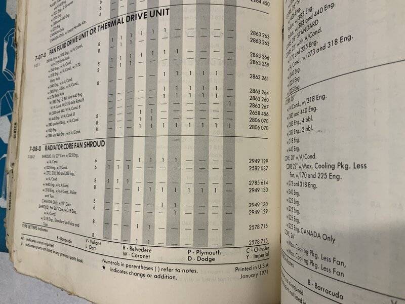

Parts book for 1970 Charger/Coronet shows 26" w/AC, w/318, 383, 426, 440 = 2998 326. It's also the same part number for '70 E-Body 340s.
I'm going to recheck since you couldn't get AC with a hemi. (That's how it's listed, so I guess it's the same for all those.)

Once again, what year is your car? They changed the shrouds for 1970.
Here is 383 26” radiator ac car from 1969 charger
It’s a 69
Are the big block shrouds the same as the small blocks? I’m not too sure.
I didn’t know 70 would be different either
Well ill check again, 26” radiator and ac car i was thinking the same maybe someone else will chime in
Thanks I appreciate it. Next time I’m out in the garage I’m going to take note of the radiator inlet/outlets and part# on the rad itself.
That’s List is not showing a R or W (B-body) with small block and AC. Why not? All V8 with A/C had a shroud.
I saw the same thing - it doesn't seem to list anything for a SB "W". That's strange. And I thought the other columns (D, C, Y) refers to C-Body cars. Do I have that correct?
That’s great! I can’t quite make out the number though
