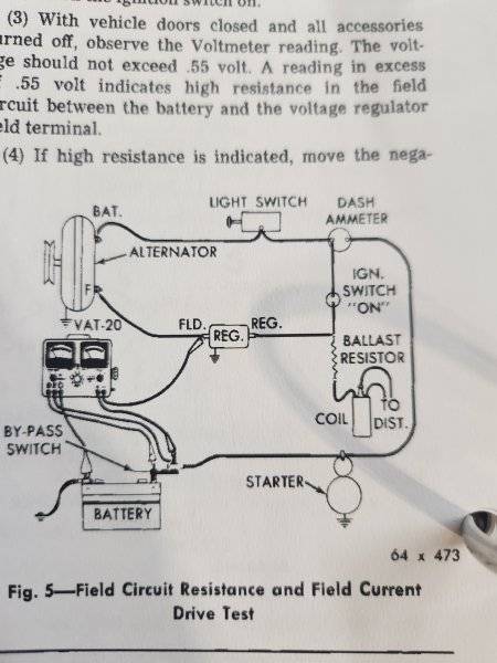

I checked across my ground side. I have 7.5ma draw that doesn't change when I pull either the fan or pump fuses. It's always started fine and had adequate voltage except for the other night when it wouldn't crank after I shut it off in the drive thru.
I also made a jumper wire and jumped across my fld and positive post during my diag earlier. I didn't write it down but I believe it was in the 14.5 range, I expected it to be higher given that I was essentially bypassing the voltage reg.
I essentially have a 2v drop from my alternator to my battery.
I am not sure my next step but I suppose I will sleep on it. Looking through my manual it appears it goes alt-lightswitch-ammeter-starter-battery. Guess I'll start checking drops across that circuit.
Thank you for your assistance
There should be almost no voltage difference between the alternator charge terminal and the battery.
I would check the bulkhead connector where the charge wire goes into the passenger compartment.
I plan on checking the wiring from my alternator to the battery along that circuit and tracking down my voltage drop after work today. Ill start at the bulk head connector. Thank you
