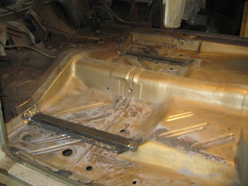

US CAR TOOLS has a weld in set of frame connectors that weld to the bottom of the car and look clean when welded in . I prefer weld in connectors . They have both long and short wheelbase sets but your best bet would be their complete chassis stiffening kit ,

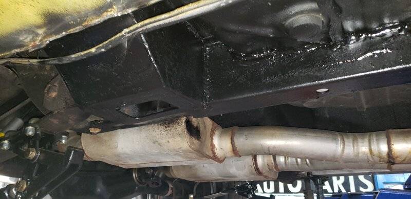

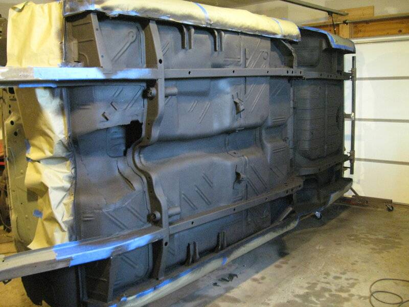

I just had almost all of the USCT frame strengthening parts installed, WELDED into my Roadrunner. The remaining parts, which are inner fender braces and radiator cradle support, are going in when I do the final prep for my 541 stroker motor.
Subframe connectors and front and rear torque boxes:

Another vote for US car tool. they fit even better then I had hoped. You may have to push up on it and also have something/ someone push down in spots but it's pretty darn close ( their all just a little different in the way the floor pans were welded from car to car). I did the whole stiffening kit, money well sent. You could make your own and do a pocket cut that would allow you to weld from the top side which is easier but then your preformed carpet wouldn't fit.
