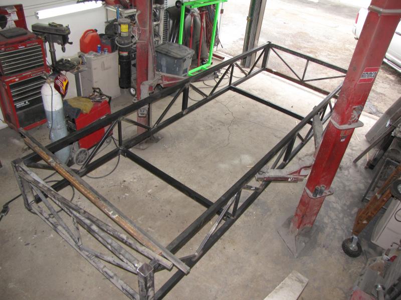

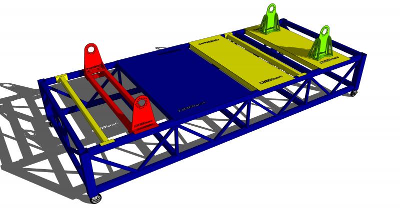

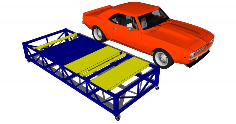

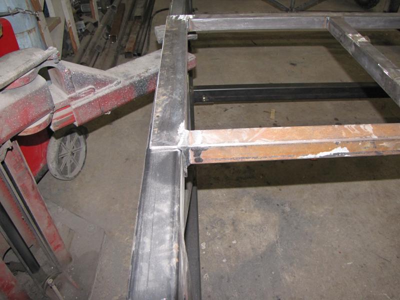

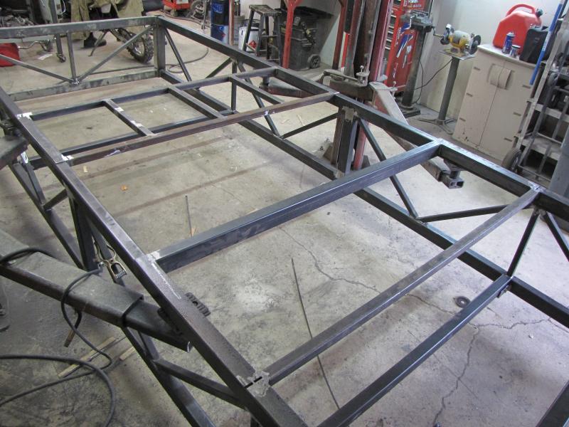

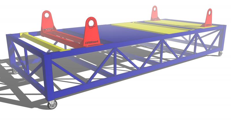

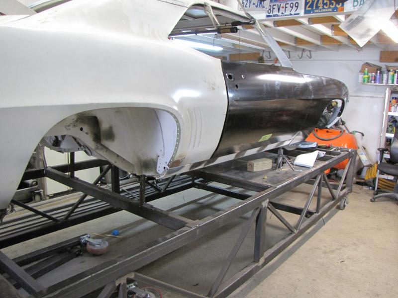

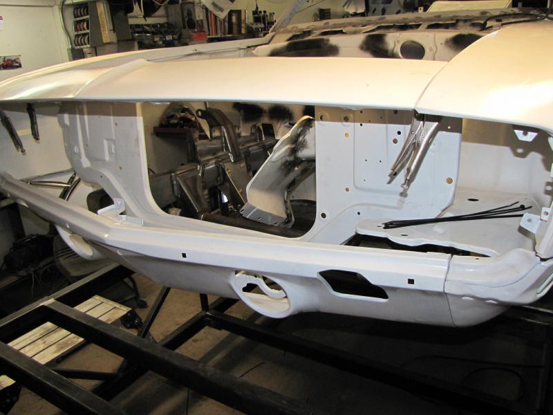

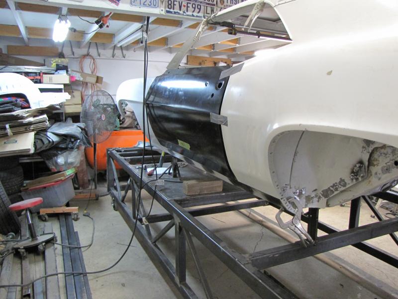

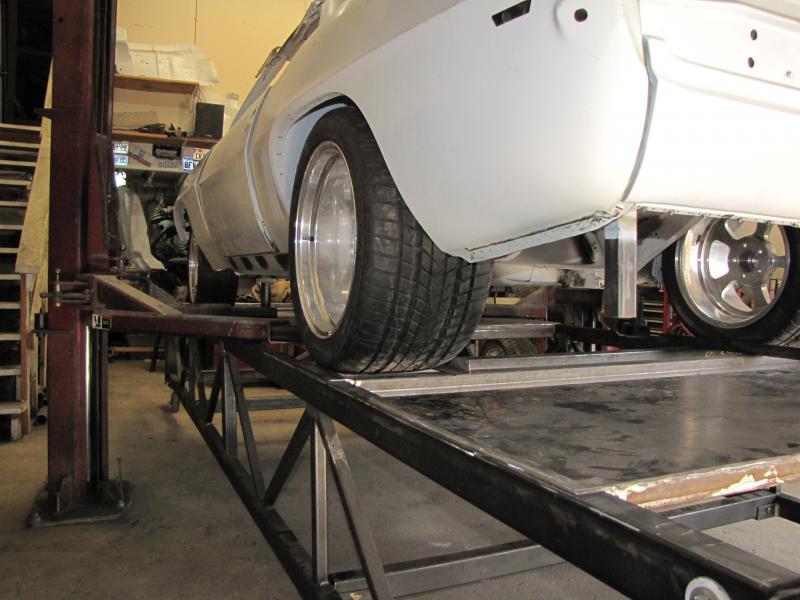

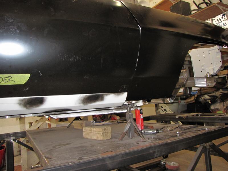

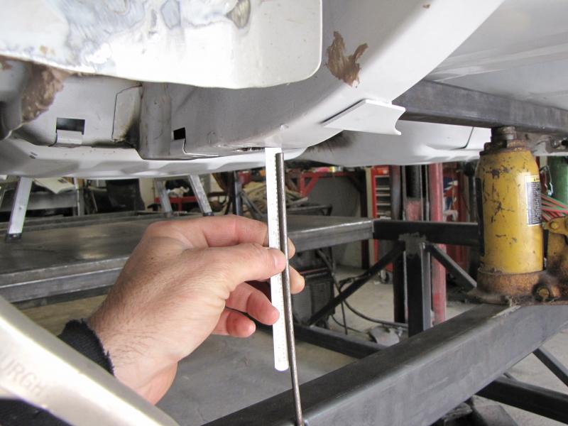

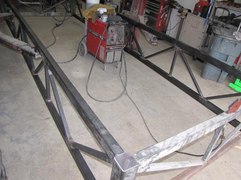

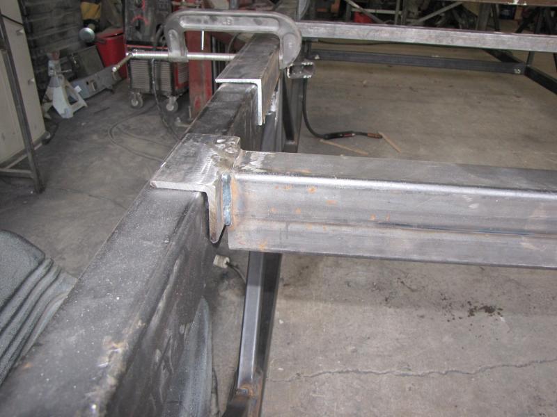

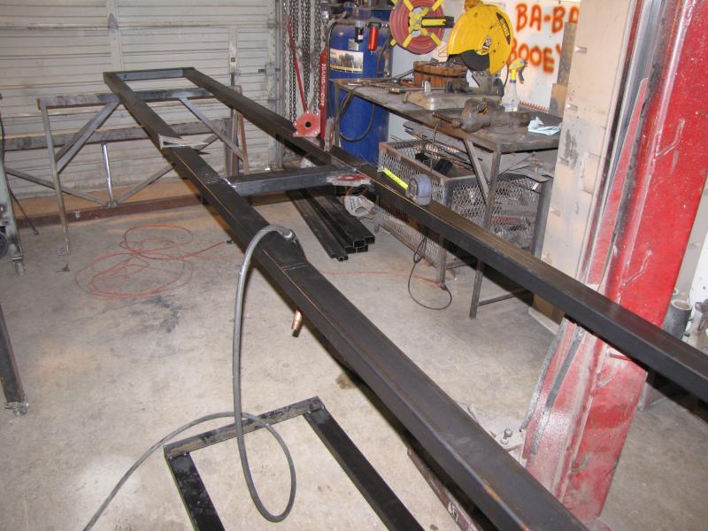

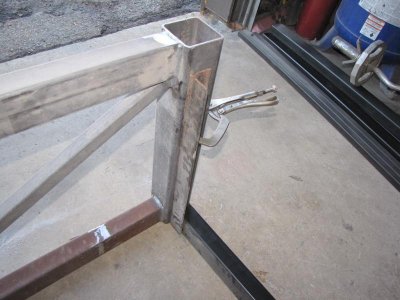

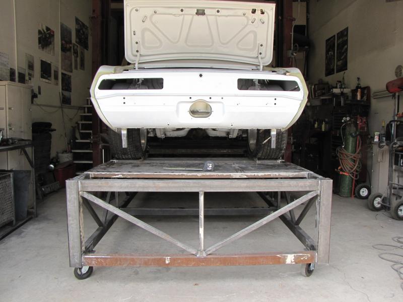

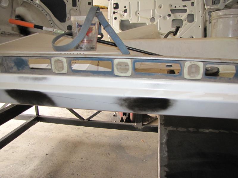

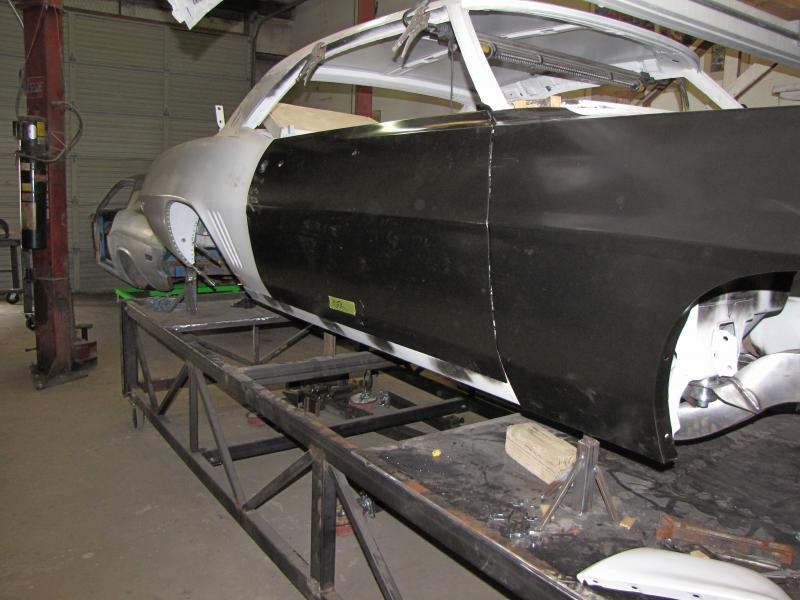

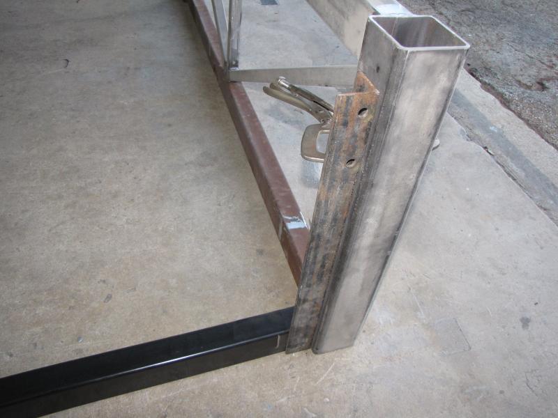

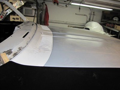

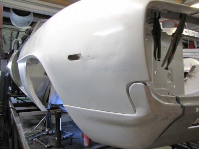

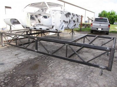

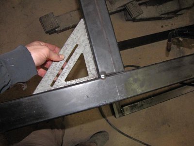

Thought I'd share my latest creation, borne out of need vs. any other reason. The 69 Camaro I'm ready to do final body welds on (Qtrs, etc) and don't want to have or rely on the Dolly, Body Cart, Lift or even a Rotisserie to do these final assembly phases.

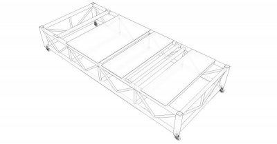

I did some preliminary drawings, and had them rendered in CAD CAM drawings, and let me tell you this will be an invaluable tool, and, I'm not really sure where to acquire a Chassis Table, so, it's a custom fab job. This is a heavy tool, with removable panels, and this is a big tool too! Initially I was not considering these factors, but, I modified it as I was building it to be modular whereas I can dissasemble it as needed.
Not sure if I'll powder coat it or epoxy prime and then apply a single stage color.
