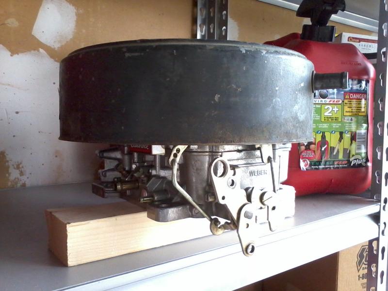

For Bob:
I see you found the one I was talking about.
Damn,, somebody musta heard us talking...........
It's only temporary. You've got three cheap guys on here, looking for what has to be one of the most common and valueless mopar air cleaners out there, so we can use it in a non-factory application, and that's probably about it. hahaha
If you pay more that $20/complete you're crazy. Outside of spark plugs and belts, and odd items that really haven't been on the market long, I refuse to pay retail for anything going on this car. So far, it has gone well. Maxie on a budget? You better believe it.
