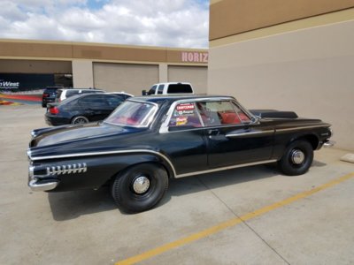

I just got a 64' Polara . Bought it as a roller and just got to work to it putting in u s car tool stiffening kit,moved springs in and mini tubbed.
