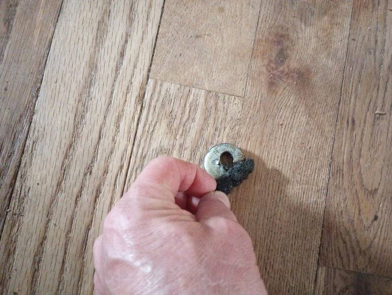

freeze plug in my Durango rusted out. I figured; Great, they are all probably getting thin...... another thing to watch out for
but no, this one had a piece of casting slag behind it, causing it to fail...... at least it was easy to get to
Humf.
I've lost both of the ones in the fronts of the heads in my Dakota.
Fingers crossed.
It looks like a piece of creosote from my stovepipe.
I like the flooring.
no room to swing a hammer....I put a rubber expansion plug in it........good to go!
