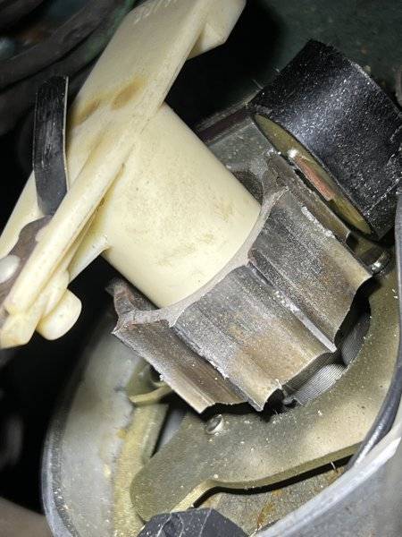

Keep chasing the issue. Looked at all the plug wires while it was night to see if spark was jumping and nothing. Pulled the wire from the MSD coil and got lit up, definitely not a weak coil. Pulled the cap again and noticed this.
All the poles on the reluctor are chipped. The chipped off metal pieces were stuck to the magnet in the back. The No clue what to do now.
Are the bushing worn out and it tilled and hit the pick up? The chipped out parts are smaller than the pick up though. Is it possible to just buy the reluctor wheel? I would guess to say this could be part of the random misfiring and breaking up problem?
Thanks
In my experience that could happen for two reasons. One of them or both together:
-Bushings worn, tipical on BB due the slanted position, not so much on SB.
-The free play of the pickup assembly plate. One of the free play issues makes to get close the pick up when vacuum advance is activated. When adjusting gap, I use to apply vacuum to be sure the gap is at least close to the adjustment. I have need to bend back and forth the pick up bracket to be sure the gap is at least on an average measure with and without vacuum applied. The pick up assembly moves in a diff radius than the reluctor so is nearly impossible to get the same gap in rest position and advanced position
Yes, reluctor is replaceable and available, but also can filed depending on how deep were the bites. I have made both. Sure when filed, needs to be sure all be made at same height.
Bushings used to be available too.
About ignition problems related to that… in my experience that never represented really an ign problem.
You need a new reluctor & I would also get a new p/up. The pole piece on the p/up is shaped to a sharp-er edge, like an arrow head. That has probably been damaged, but hard to see.
I had this happen to me when the pickup plate had not engaged fully down on the vacuum advance arm pin.
New reluctor could be ( as I mentioned, I have filed them to fix, mounted on dist yet) but new pick up I don’t think is necessary.

Possibly a bent distributor shaft. This was discussed a few days ago and maybe a “search” might come up with detailed info

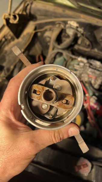

Just pulled the distributor apart to blow out all the metal flake. Could of been my fault this happend. I might of unknowing pulled on the magnetic pick up when I was trying to get the rotor off to clean it. Shaft is straight and everything else seems fine.
The engine builder that built the motor before I bought it was nice to remove one of the springs. I was gonna mess with all this while I was in there but looks like its already good to go.
Also is the vacuum spring for the advance supposed to really heavy? It was very hard to move.

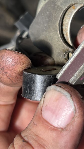

I have a 426 hemi distributor here that is electronic. Was gonna take the reluctor for the time being, but when I checked for clearances 3 of the teeth will touch the magnetic pick up while the others have a gap. Not sure what that would be. Shaft doesnt look bent and it hasnt been rubbing from what I can see. Maybe just manufacture tolerances?
The spring that was removed
The magnetic pickup on my old purple tag for the 383. Seems like it might be okay.

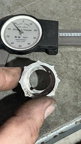

Ground down the points. Im a couple thou off on a couple of points dont know if that would make it mis. Still going to order another reluctor, cap and rotor.

You should get two springs, a soft one and a hard one… working together makes the advance curve, the soft one for the initial stage, the hard one for later stage or the second part of the curve according to the vacuum

It’s not unusual for the reluctor to pickup coil gap change as the vacuum advance moves the stator. I don’t think that reluctor is salvageable, it should be replaced before going any further. Use a vacuum pump to actuate the vacuum advance and see if the air gap changes, if it does then something is bent or worn.
Is not posible to keep same gap along the pickup run with vacuum action. This is because the radius/circunference made by the pickup coil base is not the same than the reluctor/distributor circunfence. There is not a common center, so it won’t be a parallel move ever.
You can however (I made it) bend here and there the pickup coil bracket to get the best average gap as posible.
Thanks. Going to order a new reluctor and plugs and going to see what happens.
