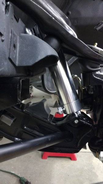

I'm not against the Bilsteins at all I have a set on my Dodge 2500 but I do think the adjustable shock will better suite my needs and I am certainly interested in the Vikings I did a bit of looking and like what I'm seeing I definitely want something that is gonna be with me as I move along and upgrade. I guess I'll have to give you a call James. Thanks for the all the help and replies I really do appreciate it.
