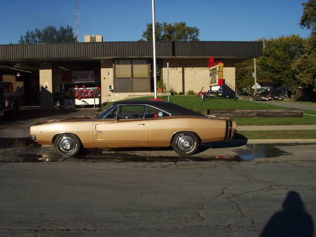

I am about getting 1968 Dodge Charger roadable for long trips and want to do all connections under the hood, so I don't have and breakdowns. I want to clean the terminals where they go into firewall block under the hood. Thanks to all you guys who gave me some of your knowledge on how to clean electrical terminals. thanks to you all "493Mike", "kiwigty", vance.dykes", Dave6T4", and AR67GTX". Bob Horman
