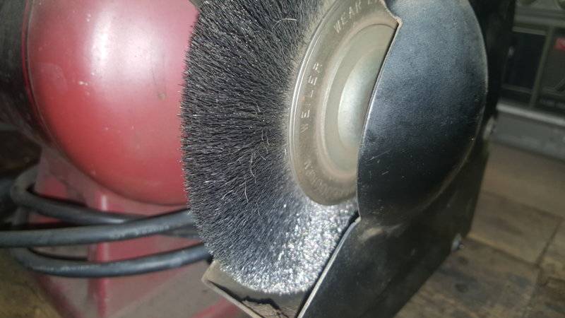

I can't remember where I bought this one but it's over 20 years old. Weiler, made in USA. It's a very fine wire. Look at my build thread and you can imagine how many bolts and nuts I cleaned up. A fine wire will clean and polish. Seems to last longer than a course wire wheel will.

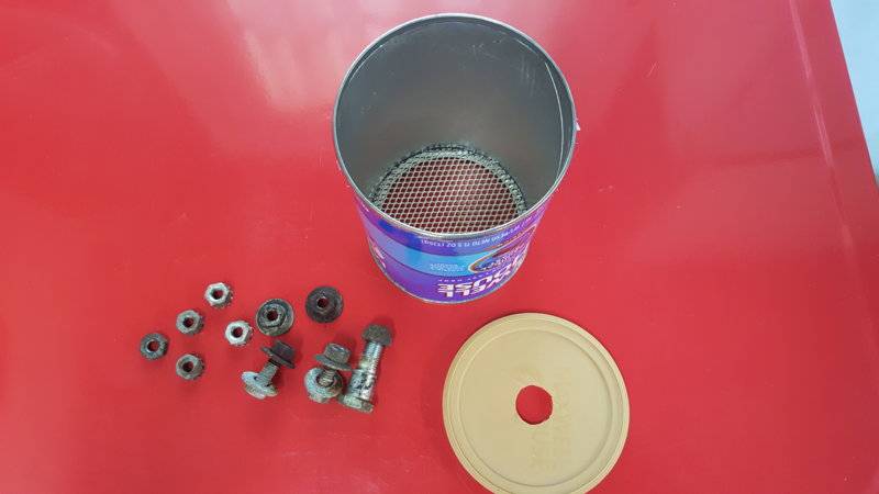

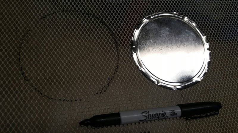

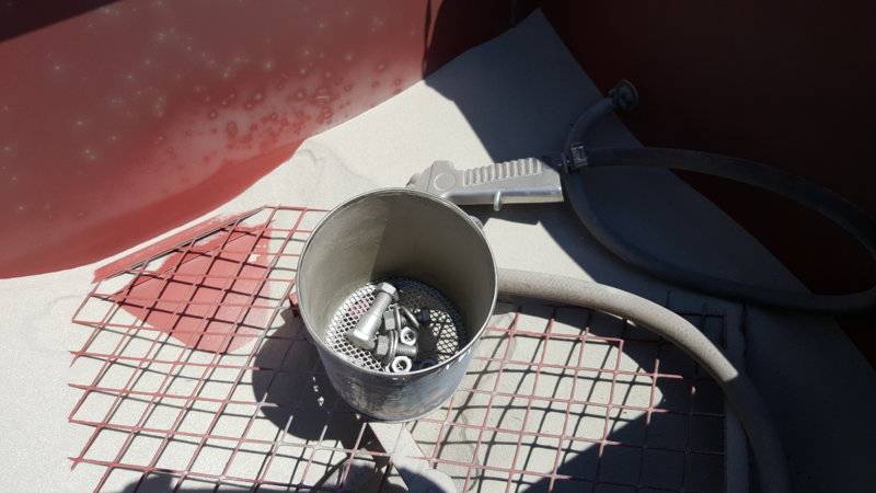

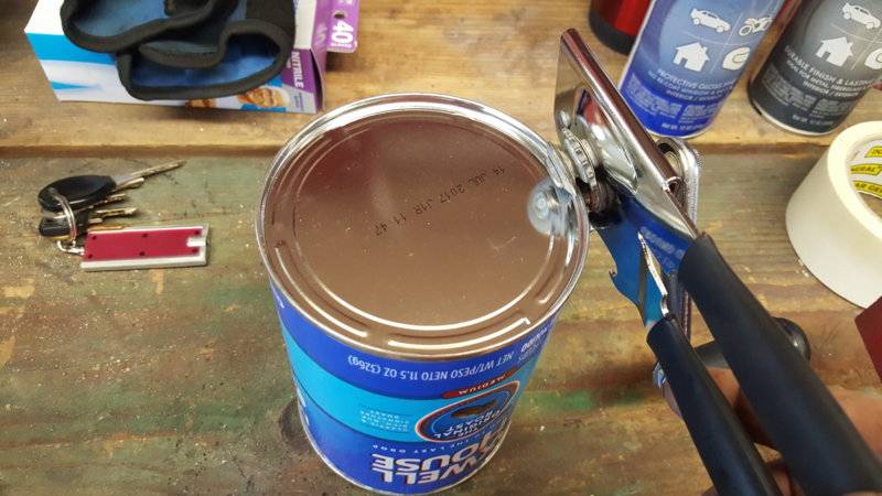

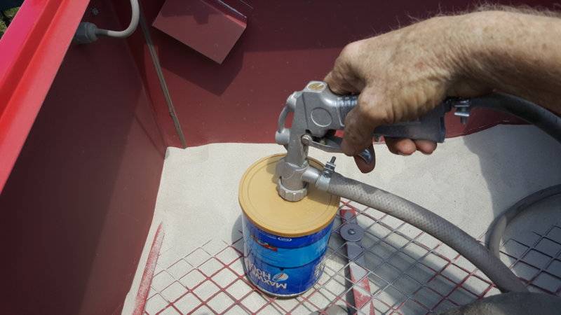

Here's a neat idea for your blasting cabinet.
