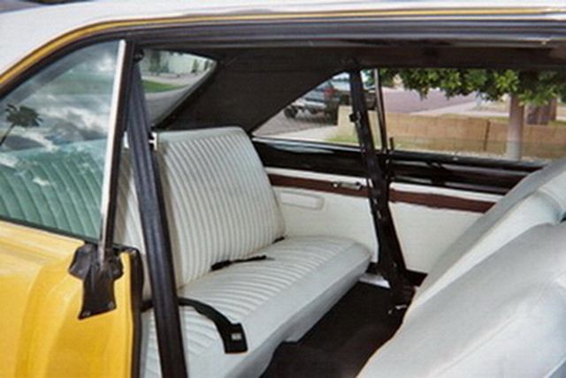

My son's 72 Dart has a white interior and I used to own a 70 Charger R/T with a white interior. I just always used warm water and a mild soap solution to keep everything clean. I'm getting ready to instal a brand new pearl white interior on my 66 Coronet, so I will be taking notes from this thread on newer products that are available. :sSig_nicethread:
Richard
1972 Dart Swinger- restored with BEAUTIFUL Legendary Auto Interior products! .jpg
