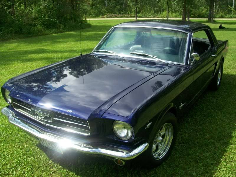

Don't tell anybody but... I had a few clear runs in this little coupe.
She buffed out ok and yours will too.

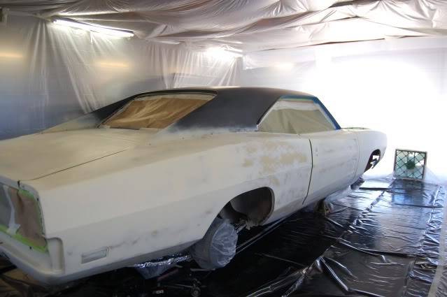

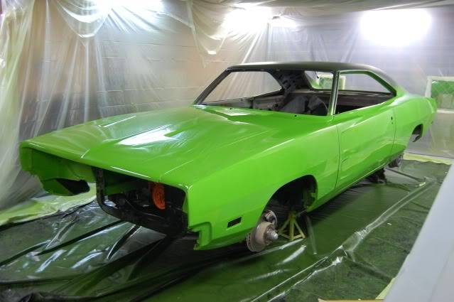

Looks great! I went through the same process as you, I painted my car in a homemade booth in my shop last October. I had about the same issues as you....I could have used more lighting, had a little trash in my paint...a couple of runs but it all buffed out good. I had two box fans blowing into the rear of the booth (through filters) and 2 pulling air out at the front (also through filters) and it cleared up pretty good, next time I might add another fan pulling, but all in all I was happy with how my car turned out.
