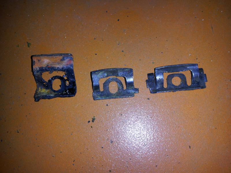

I took out my windshield today and saw there was 3 different types of window trim clips. Some were missing because they rusted out. Does anyone know how these clips are to be positioned and in what order they should be reattached....
Thanking you in advance for all your help..
20130108_125357.jpg These are the clips I took off of the car.

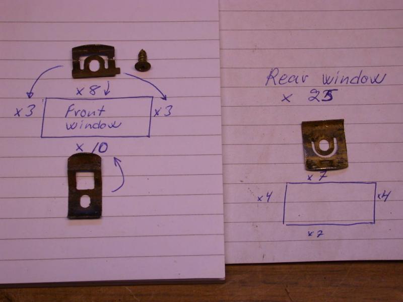

Don't know if it helps but here is a drawing I made from my 1967 Charger...

thanks for pic.69 is a little different not much its's the clip to far right that is the issue there's 4 i think one on top corner of windshield and one on top of pillar. something else when i ordered clips there's only24 i have 26 holes. being 2nd owner i know who bought the car new they never had windshield out same with your car 24 why 26 on mine. some pics.i took are of whole window area not close up of clips my mistake
front window yes back window no
