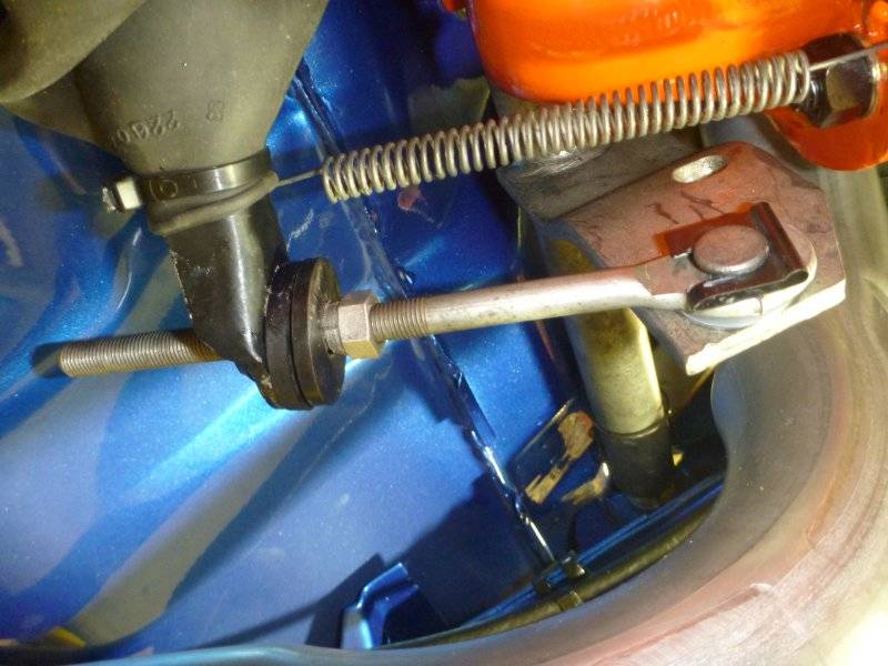

I would lube all the linkage pivots and remove the inspection cover. Adjust the air gap between the throw out bearing and the pressure plate fingers to about 3/16", cycle the clutch a few times and recheck.

Pedal all the way up, adjust the forks threaded push rod until you only have about 3/16" of play between rods nut/washers and the fork "socket", when pulling the fork back.
So... you should be able to pull back on the fork, via the washer, so that the throw out bearing hits the pressure plate and have about 3/16" of slop between the washer and the nut. Adjust the nut until you have that "free play".
