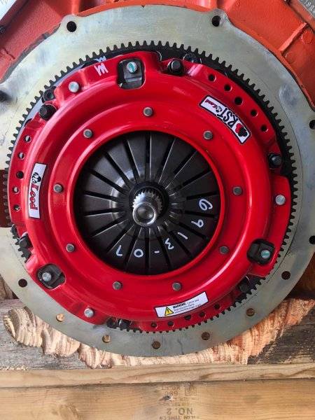

I'm using a McLeod RST with TKO600. It's a twin disc, organic friction material. Pedal is light and the clutch is super smooth.

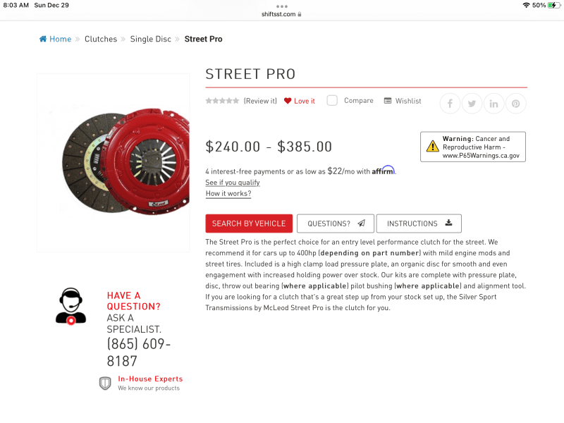

Not much action here. I too am shopping for a clutch. SST TKO 440. When i broke down in Mississippi (fuel pump in tank failed) it had to be revved and walked a few miles to get away from the Clantons and wait in a safe place for AAA. This at the cost of the clutch. Lots of riding. It smelled bad and still works but has a lousy chatter launch. Looking for good street clutch to handle about 415 RWHP. Lots of traffic here. I’ve transitioned from performance to reliability and ease of use. Don’t remember what’s in there now.
