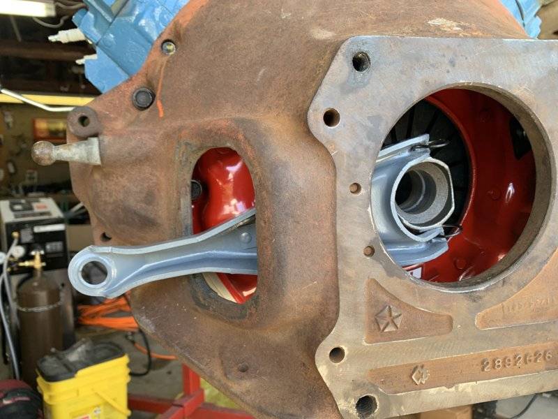

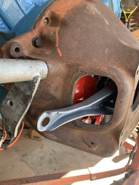

I am building a big block with 11” cast iron bellhousing. I have collected parts that I think are right. My question is do I have the wrong z bar or clutch fork? It’s going in a 73 b body.
Push that throw out bearing up against the pressure plate forks, correctly centered and take another picture.
Since that bellhousing wasn't used in the '73 B-body, the Z-bar and fork are probably both wrong.

Do your self a favor and talk to Brewers before your install in the car. i installed the wrong fork and had to install the correct fork with the engine in the car. Had too bump out the trans to re-install the correct fork, pain in the ***.
They will ask you to measure the length of the fork, b-body i believe was about 10-3/4 long. The A-body was about 11-1/2" long. Guess what came in my parts box's when i got the car. Factor was the fork did not align with the z-bar.
Also you have the 18 finger pressure plate, you dont need the over center spring on the pedal. It just keeps the pedal on the floor.
