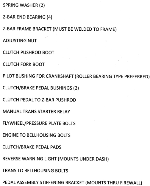

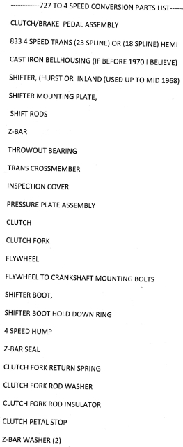

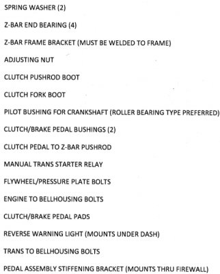

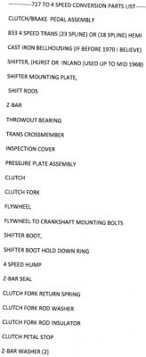

Hello, parts are available from many sources, such as the vendors listed, ebay, other members on this forum etc. Attached is a list that I came up with to convert from a 727 to 4 speed. Even though mine is a '68 , the '73 should be very similar. Good luck.
