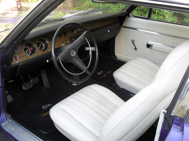

I know this car started out as a 3 speed and was converted to a 4....but here is a pic of the pedals.

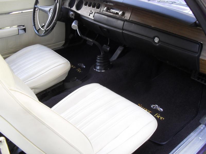

And I know the shifter is wrong also, but that's easy....

you can see it in this pic also

Don't worry about where the clutch pedal ends up, just adjust the clutch and run it.
My clutch pedal was lower than the brake pedal with an old Zoom clutch I had, roughly even with my current clutch and higher than the brake pedal with an old Hays clutch. If you need to adjust the clutch so the pedal is 1" or so higher than the brake the over-center spring will make the clutch pedal go all the way up. No big deal.
On my centerforce and zoom clutches i took that spring out.... Counterweights effected it. Would cause the pedal to "stick to the floor" under heavy acceleration between shifts.
