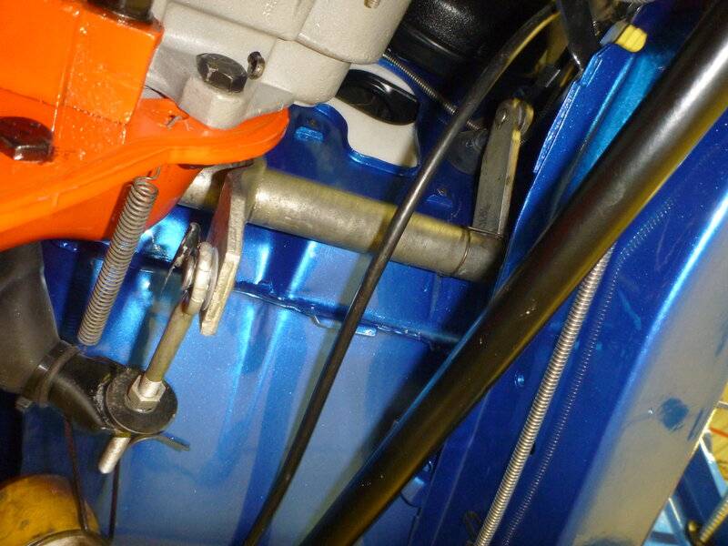

Heres The Pic On My 69 Roadrunner Clutch Rod. The Car Is a Big Block. The Z-bar Measures 9 1/8 Overall. Not Sure The Fork Size.
Is This Angle Correct?
That doesn't look right to me. But I couldn't tell you what is wrong. My guess it's the z bar?
Your Z bar is in reversed! It should have an offset, straight side to the fender.
Yes, what the other two have said, and I think the fork length looks a little short too (might just be the angle the picture was taken though). You should know how long the fork is. There are different lengths for different applications
Thanks Guys. I’ll Reverse it This Weekend And Hopefully Everything Lines Up
I Appreciate The Replys
