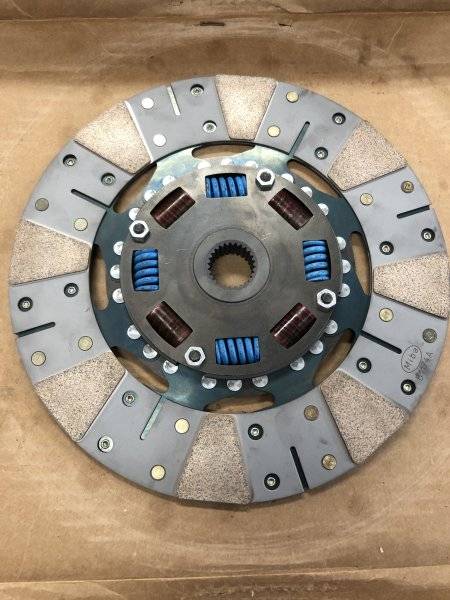

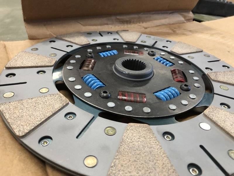

I converted my car from a 727 to a 5 speed using a clutch that looks like this:
This dude GRIPS but sometimes does shudder a little.
I'd think that persistent shudder would affect the U-joints but a little bit every so often shouldn't pose a problem.

I think the dual friction discs may under certain circumstances chatter or shudder a little. I have a dual friction McLeod clutch with a new, high dollar aluminum flywheel in my 66 Corvette. In normal driving it is very smooth and not a hint of chatter. Arriving back at the garage with it heated up and feathering it more than normal while negotiating a 90 degree turn into the garage it will start to chatter some.
But normally chatter or shudder is an indication of warped or worn parts or heavily glazed flywheel or disc. Chances are it will need a flywheel resurfacing and new clutch to get it smooth again,
Mine shudders, it's the dual friction disc. I may down the road do what AJ says, use a stock disc if you want smooth. Resurfaced Centerforce flywheel and new clutch disc and pressure plate, still shutters a little.

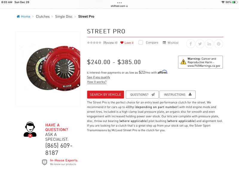

I ordered this one today from SST. Allowing plenty shake down time for Los Angeles trip.
If you call, ask for Tech. Wade took order. Sounds imformed.
I have the next one up, the Super Street Pro, considering I've watched how you drive your Coronet I think you would be happy with either clutch but the SSP might live longer...
