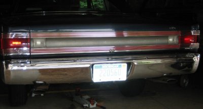

I sanded and polished my tail panel back in 87 - the pic was taken last Summer!!!
Gary
