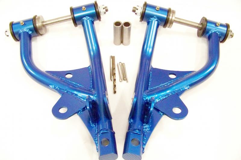

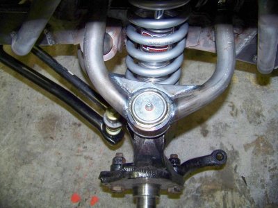

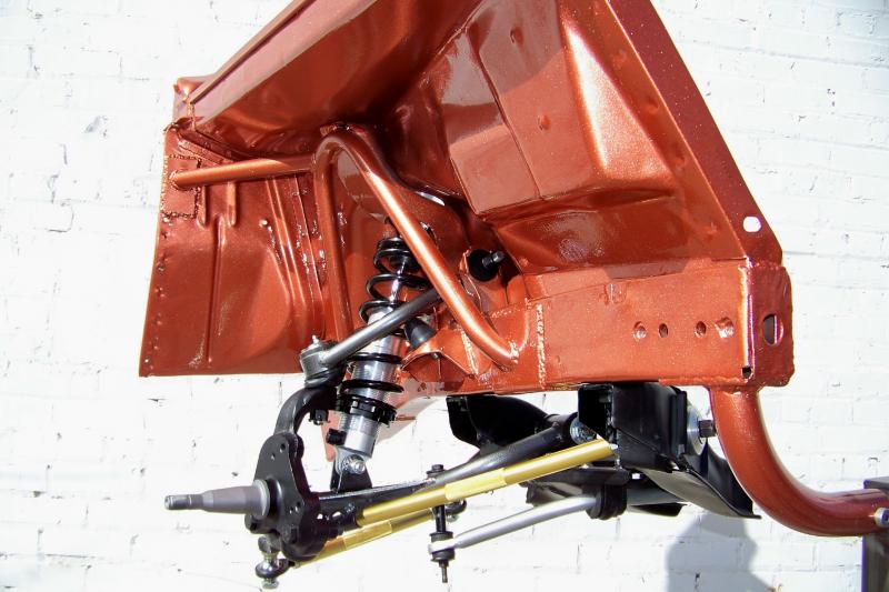

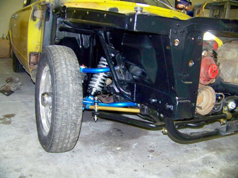

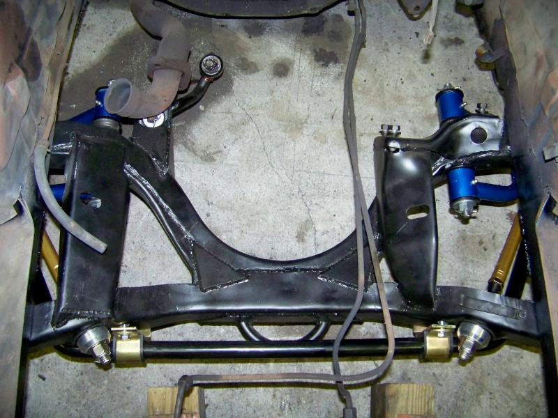

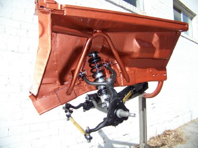

Some of you may know me from over at FABO. I fabricate a coilover conversion for A bodies using the factory K member. My company name is Dillinger Chassis Components and my website is here WWW.Dillingerchassis.com The conversions have been fairly popular for guys wanting additional header clearance, additional adjustment with my upper and lower control arms, less weight and retain their factory brakes, spindles and steering.
I am just curious how much interest there would be with this conversion for the B and E body crowd? I have owned a couple of b bodies in the past, but I am not familiar with how upper and lower arms differ from the later cars to the early cars? I know many vendors have one part number for all bodies, so I am sure that they are similar.
I have a K member, spindles, uppers, lowers and strut rods from an E body that will help me set up my jigs and get going on this project.
Just so you are aware all parts are top shelf stuff. All of the tubing is thick wall DOM tubing that is 100% tig welded and Sleeves and Heims are Chromoly.

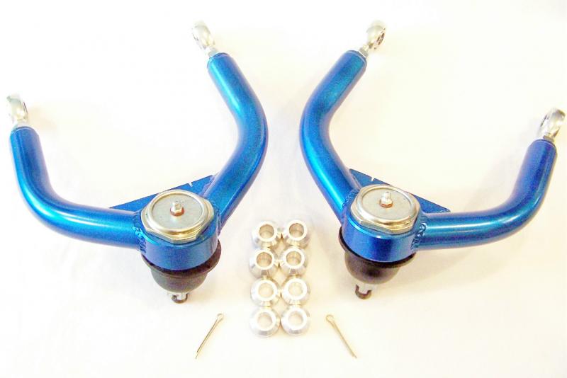

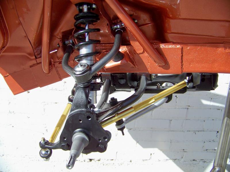

More parts from my display.

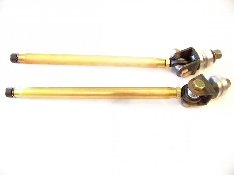

I make those already for the E bodies. The price is the same a A bodies on my site. They come with Chromoly Adjusters and QA1 high misalignment Chromoly Heims that are teflon lined. They really free up the front suspension.
Can you expand on the frees up front suspension comment? I had considered running strut rods like these from hotchkis but changed my mind and just put new rubber on my stock strut rods cuz I was afraid of too harsh a ride and possible k frame damage with street driving. The roads in much of northern california bay area are not that great. . .
Should I reconsider? Are there differences in suspension response besides the stiffer feel?
I guess freeing up the front suspension isn't the best choice of words. There is much less resistance with droop and compression compared to a stiff bushing.
Some guys are concerned with binding running a setup like this. I have taken a small video with one of my lower control arms installed and I could move it with one finger through then suspension cycle. Running a factory arm would be the same deal because you still have a bushing in the pivot for the lower control arm.
As far as damage to the K member goes, I am yet to see any and I have had friends running this style setup for a couple of years with no issues. The main advantage of this style strut rod is retaining positive caster under hard braking.
http://www.youtube.com/watch?v=DMmAXI8bvNc&feature=plcp
Thanks for the info! Can you tell me if and how these strut rods are different than the ones Hotchkis sells, if at all? I'm a bit familiar with those since I had them on the car and then swapped them out after my mechanic scared me with stories of broken k-frames. Now I'm thinking about going back to strut rods like these. It did give the car a nicer feel to me when driving.

Don't forget about the anti sway bar placement difference between the earlier B bodies and the 70-72 B bodies and how they attach to the LCA's. I'm sure people are concerned with the weak shock towers in these cars. I see in all your pictures that the shock towers are reinforced. Some people may not want to do this to their cars. Good idea and I'm looking forward to the responses of people who run them.
