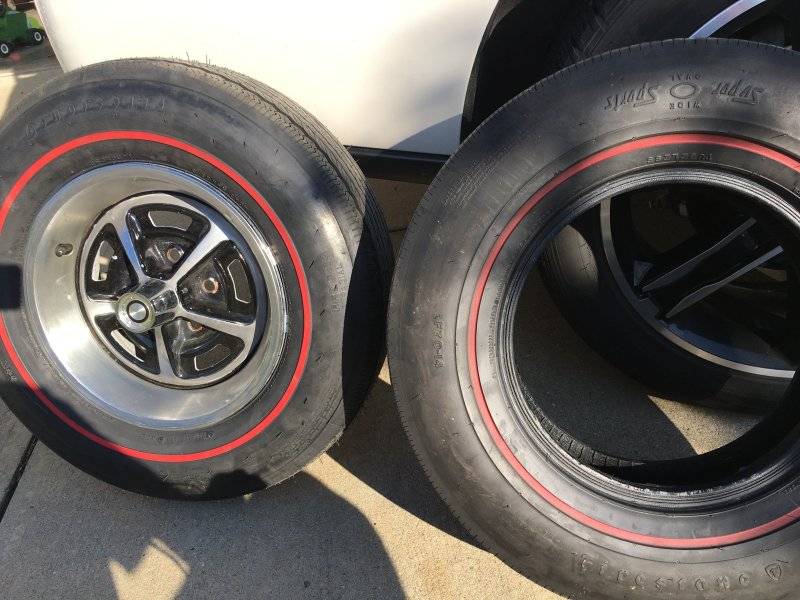

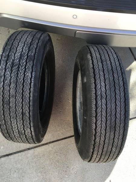

Here they are side by side. I’d say loosely based on bias plys would be how I would describe them. The redline is inset on the old tires, and raised on the radials.
Bias ply tires and radial tires have completely different construction.
The tires width measurement is not on the tread but a sidewall section measurement.
Radial tires by design have the tread area and the sidewall area acting independently from each other.
The radial tire maintains tread contact on turns, bias ply tires have the tread contact patch lifting from the pavement on turns, losing traction.
This is one reason that bias ply tires had a flatter/wider tread. To help cornering traction, radial tires by design don't need the extra tread width to get traction.

Thanks for the pic. Side by side definitely shows the difference. I had been trying to tell just looking at non side by side pics and it wasn’t easy. Overall the responses seem like the ride and quality is not much better.
