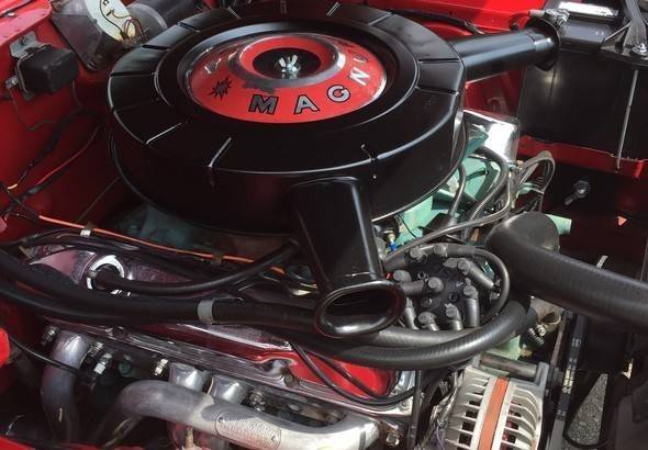

375hp 440. turquoise. Chrome valve covers and headers added
Like this. Air cleaner above is correct. There is a debate between wrinkle or gloss finish. Access to another original car says wrinkle for 11/67 build date.
Chrome valve covers are factory. In the picture below they are chrome under all the dirt.
Turquoise is the right color like stated above.

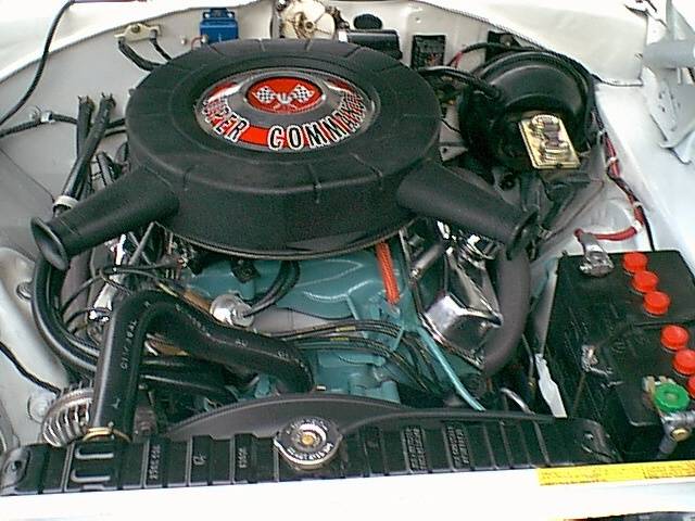

This engine bay looks pretty good. Picture borrowed from the internet. Plymouth GTX more than likely but pie tin is really the only difference.
There is a good article on mopar air filter housings that states that the duel snorkel with 13 indents on top and oval intakes is correct for 1967, but some cars did come with a round unsilenced housings in 1967.
